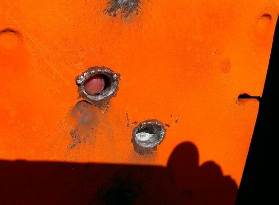

Pierced ? Yes/No: YES
Material Type: Steel (mild ?)
Material Thickness: 0.5"
Target Supported or hanging: Hanging
Cartridge Used: 300 Win.Mag.
Reloads/Factory: Reloads
projectile Make: Hornady
Projectile Type: A-max
Projectile weight: 178gr
Projectile Comments:
Target Distance: 328 yards (300meters)
Velocity @ Target: 2,445 fps
Energy @ target: 2,365 ft-lbs.
Overall Comments: End of range day I had 2 cartridges left so I shot them fast at a 300meter gong.
This is a mild load for mid-range. 3,030 fps at the muzzle (26"bbl)
Reached around the gong and stuck my pinkie in the hole for the pic
I think it was the second shot that made the hole, but not 100% sure since I shot them as fast as possible with out sacrificing too much accuracy.
Treat that trigger like its your first date, not like youve been married to it for 20 years.
