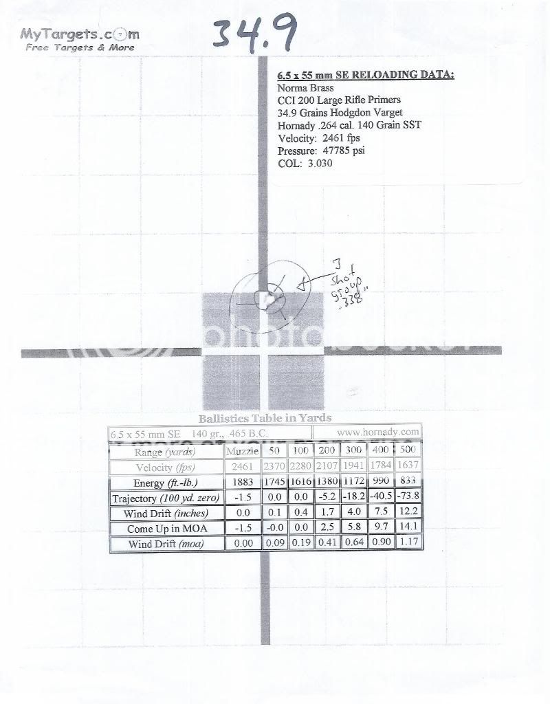

3 Shot group from the same .30-06 with a 165 gr SST:

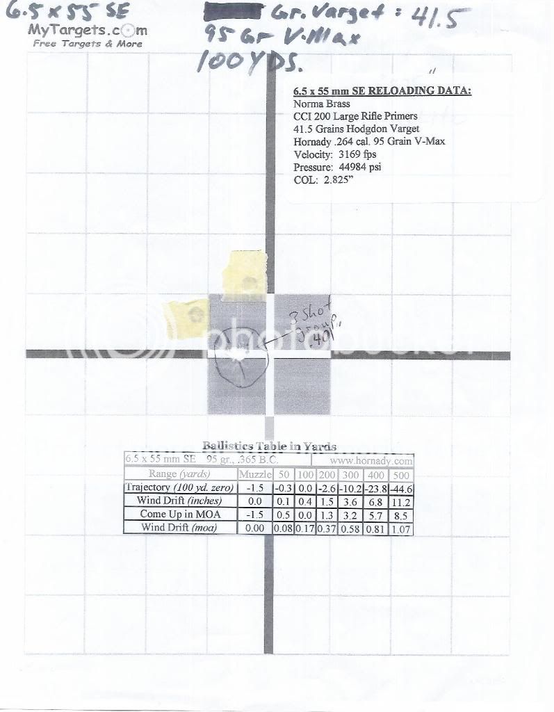

This is another 3 shot group @ 100 yds with another Tikka T3 Lite SS in 6.5 x 55 SE:
The same rifle shooting a 95 gr V-Max:
So as you say, yes I will crimp and degrade my rifles accuracy, thank you very much. Also thanks for asking whether I was a competition shooter or just plinking/ hunting. All of those targets were shot from a sandbag laying on a bench, none of them crimped on a cannelure, or some of the bullets were even crimped without a cannelure. Just for S&G, here is a picture of a .243 target that was crimped in the cannelure:
I believe that all of them qualify as hunting rounds. Also, manuals are guides, not Bibles. If you read the Hornady manual, Lee manual, and Lyman's manual, all of them suggest a crimp amnd not just for bullets with cannelures, or ammunition used in magazines (tubular or otherwise), or even in revolvers. So you maybe have vastly more experience than anybody on here on competition loading, but this is my experience with what I am doing with hunting ammunition and it works damn well for me and several others. Good luck and stay safe
