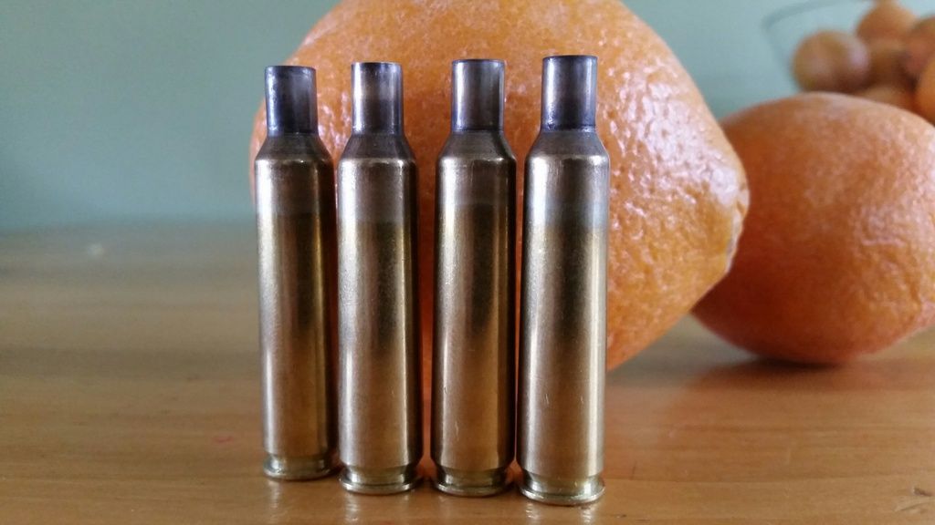

I do my annealing in a dark room with a propane torch and a gentle flame aiming at the shoulder of the cases. I shop at the exact moment when the first red apprears.

Steph,
Your color vision produces results similar to mine but I don't get color down the case body that far. The problem is that the ones you don't catch right and glow any color on you are over annealed. Your oxidation line from annealing is not consistent from case to case. Your annealing could be at fault. I aim to get the color line at the Datum Point. You aim your heat source farther from the case mouth than I do.
A practical way to check your annealing for the Reloader is going to cost you 2 of your brass cases, one you annealed versus one new factory. You use a needle nose and work the brass neck back and forth to ruin it and see if it gets brittle and cracks or it softens and tears as you keep it pinched and wiggle it's neck wall to death....Then just decide which you would rather shoot. Hint: both your annealed case a factory new case should feel exactly the same.

At the mouth this is how I used to do it, but after seeing so many pictures and videos of annealed brass, I was now aiming more at the shoulder.. ho well.... I even bought a themomelt pencil, a Markal 750F, but it doesn't work on brass. I should have bought the other brand ....
annealing without a machine is like doing sorcery... not easy to get everybody happy
but I agree my skill can be improved.
