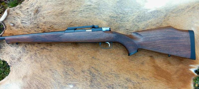

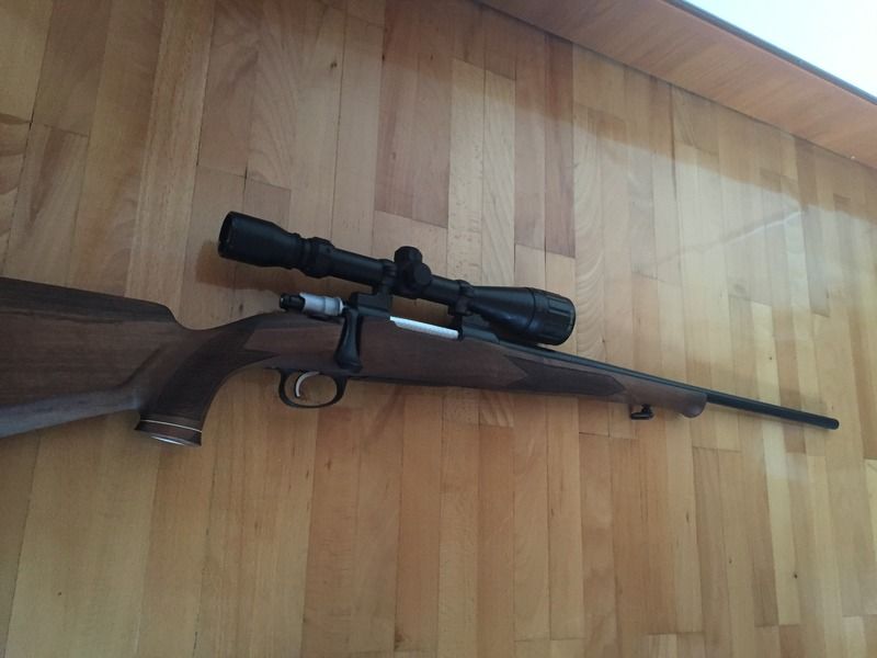

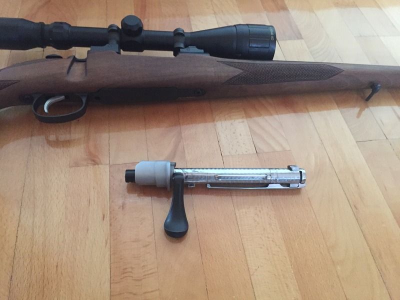

Posted - Feb 16 2017 :  15:48:03  Show Profile Send UlicniTrkac a Private Message  Reply with Quote
Here are the pics
note - scope is different now
Edited by - UlicniTrkac on Mar 01 2017 18:10:27
9125 Posts
Posted - Feb 16 2017 :  16:07:43  Show Profile Send Shastaboat a Private Message  Reply with Quote
Nice European sporter. Where are you located?

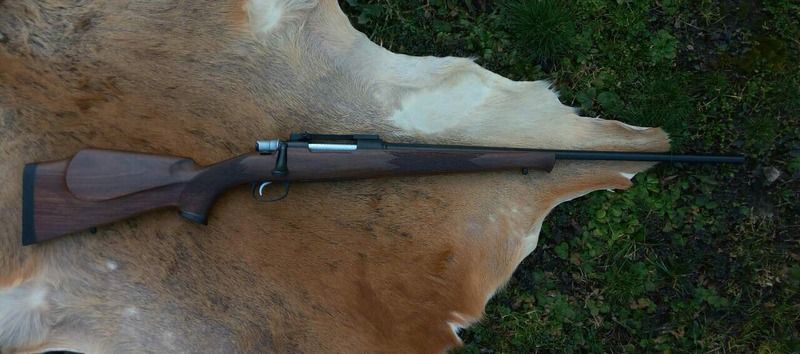

Posted - Feb 28 2017 :  01:55:44  Show Profile Send UlicniTrkac a Private Message  Reply with Quote
I had to have a new stock made, the previous one (made and bought last year) broke at the toe of the breech :(
This one is waay better :)

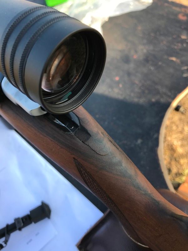

Posted - Feb 28 2017 :  12:04:45  Show Profile Send Shastaboat a Private Message  Reply with Quote
At the tang or at the recoil lug area? Poor bedding caused either. Post a pic of the broken stock please.
UlicniTrkac
New Member
29 Posts
Posted - Mar 01 2017 :  18:07:05  Show Profile Send UlicniTrkac a Private Message  Reply with Quote
I havent done any bedding on the old one (nor on the new one) - both were made by experienced stock makers, but the first one, well it seems that he wasnt up to the task. raw wood and poor fitting caused this (I suppose you referred to fitting/bedding)
WonderMan4
2851 Posts
Posted - Mar 01 2017 :  23:12:13  Show Profile Send WonderMan4 a Private Message  Reply with Quote
I notice you have a left handed stock on a right handed rifle. It looks really good.

9125 Posts
Posted - Mar 02 2017 :  00:29:19  Show Profile Send Shastaboat a Private Message  Reply with Quote
That crack at the tang is caused when you don't cut the stock tang area, (relieve) back approx 1/32". A common error when doing stock work. Quite repairable by epoxying the piece back in and then doing a relief cut. Check your new stock and make sure it has a relief cut the entire semi circle of the tang area.
