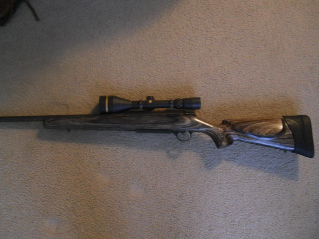

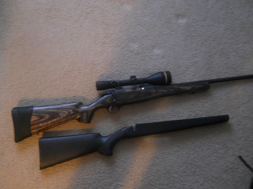

Posted - Jan 24 2013 :  15:25:55  Show Profile Send mhiltz a Private Message  Reply with Quote
I thought I would follow up on this since I have some time on my hands. Thanks to Onandaga, and Wolfgang on sharing their knowledge.
This stock took me a couple months to do. I was pretty slow at it. I had a lot of fun doing it, and it looks alright. I think it is a pretty rifle now. It shoots very good. I glass bedded the action, and free floated the barrel. One of the hardest things to do was to correctly install the sling studs. I look forward to doing this again soon on one of my Savages.
