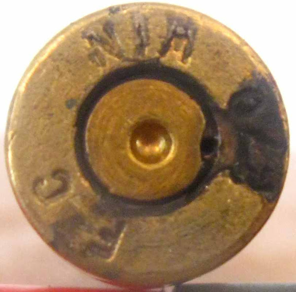

Posted - Jun 12 2012 :  11:29:58  Show Profile Send Savage99 a Private Message  Reply with Quote
marshhawk,
Please post a picture of the failure.
Here is a failure that seems to be from a primer.
The cause seems, to me, to be an inclusion in the metal when the primer was formed.
