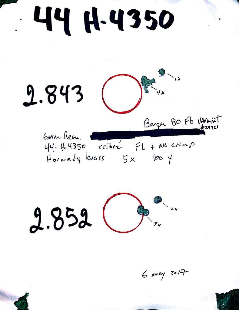

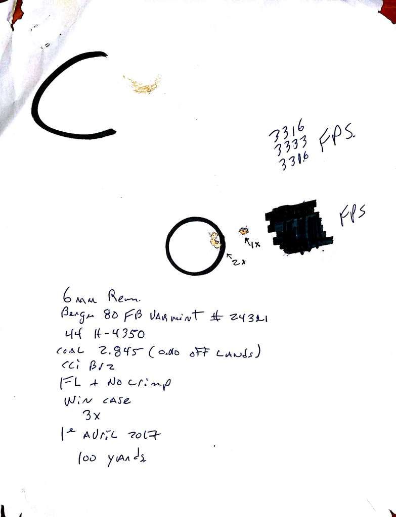

You guys remember I was telling you about my 6mm rem shooting tight groups but always with some flyers.... today I was looking at my targets and something looks fishy (to me anyway)... seems like the flyer is always at the same spot, or close to...
these 3 groups are the same recipe, but different seating depths and different dates
(I'm now thinking that my beloved el cheapo BSA fix 25x Japan had given up on me....( I don't know maybe the reticule is moving around ? ))
what do you think is happening here ?
thanks
stef

Willie T Posted - May 08 2017 : 21:23:38
If you overlay all 3 targets you have two distinct groups. The first thing I would suspect is bedding. An action that is moving around just a smudge can sometimes have that effect. Re torque your action screws and see if it settles down. If that does not help, seperate the stock from the action and put a light coat of chalk or blacking on the action and reassemble. Torque everything down then take it back apart. It will show where the contact points are and what your fit is like. I would also check the scope for parallax. I have no experience with bsa scopes but if you have parallax at the range you are shooting an inconsistent mount could also be the culprit.
